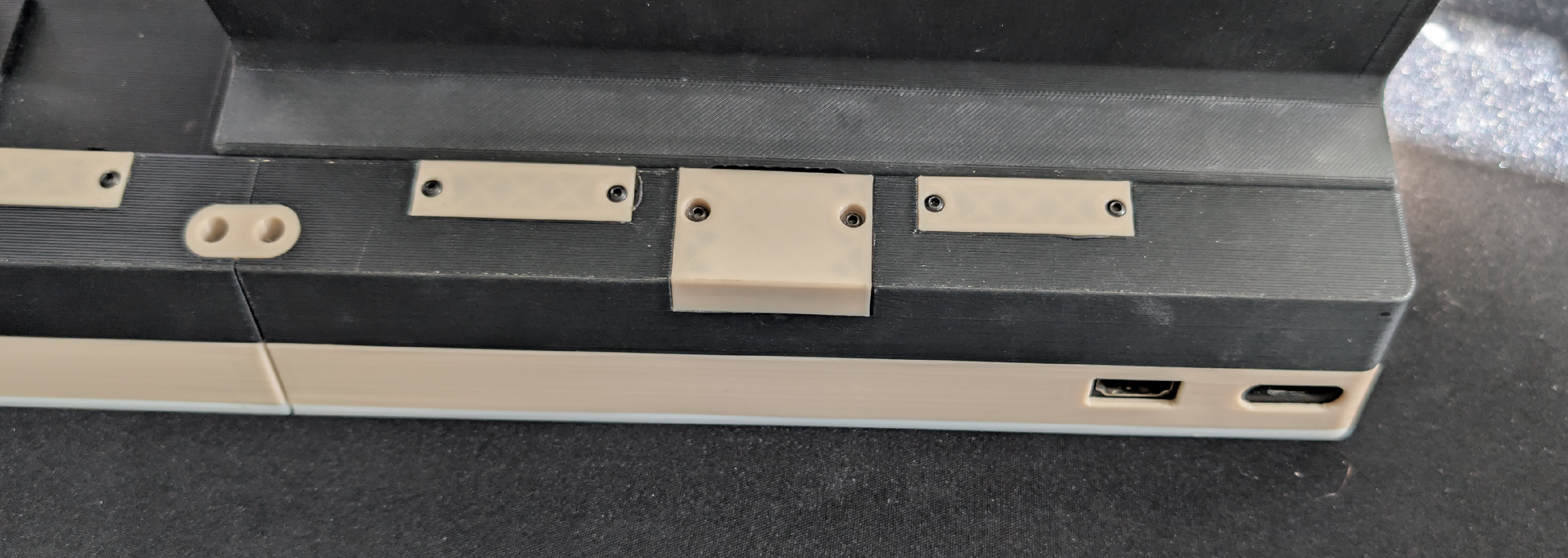

  • On Pogo Pins, Rail System Upgrade
    Nick04/15/2024 at 05:55 0 comments
    Connecting each device via a USB cable creates a mess of wires out the back of the frame.
    The unga bunga way around that is some kind of bulky shroud that conceals them.
    Instead I'm going to see if I can incorporate pogo pin connectors to the rail ends and modules.
    I ordered these 4-pin pairs on AliExpress, which have PH2.0 plugs on the wire ends.
    At the frame side, a short USB male to PH2.0 female adapter should be fine, and makes replacing them easy if I need to later on.
    For the module end, I'll do the same but in reverse: PH2.0 female to USB A female, then very short (probably custom) relevant USB cables as required for whatever devices.

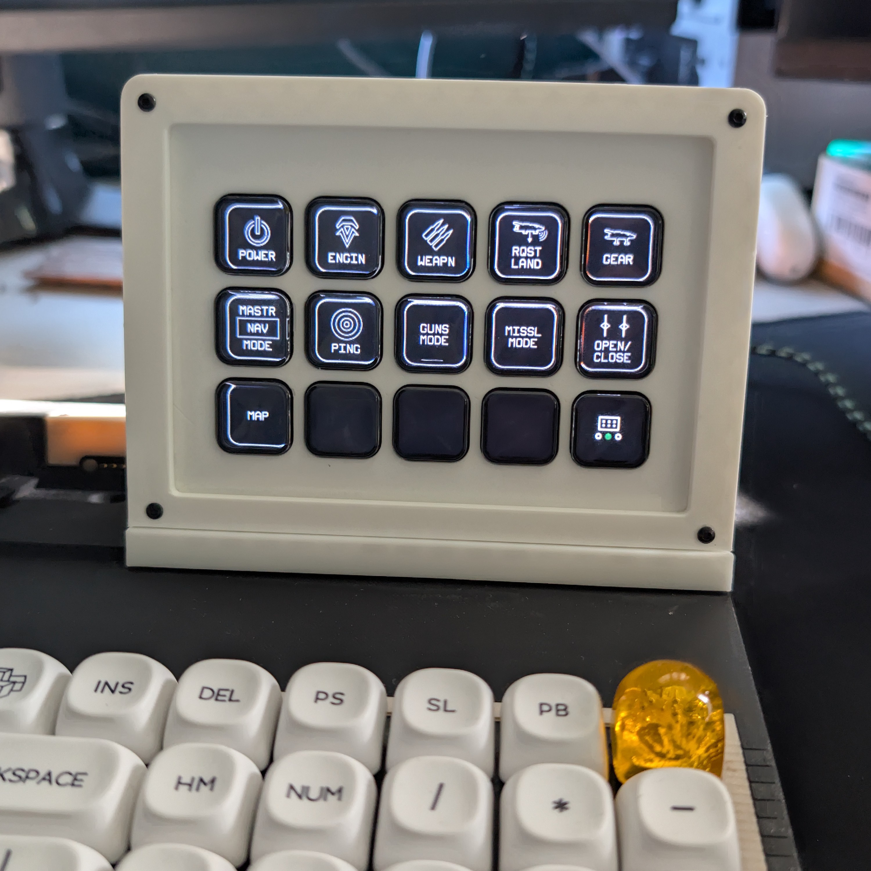

    From there, I was inspired by those notebooks with an LCD attached to the top of the palm rest.
    I found a panel LCD on Amazon, and came up with a way to attach it to the frame. It went through several iterations, but this is where it is currently (aside from a few slight changes).
    Beneath the cable channel is the LCD flex cable. The purpose of making the driver board separate to the LCD enclosure itself is, 1. ease of printing, and 2. the ability to modify one without also reprinting the other.
    Unfortunately, the LCD is wide enough that the VFD module can't be used at the same time, so these two modules can't be in the same setup.
    That said, there aren't going to be many that can be used with it. Currently I only have two others, one of which is a 'companion' module.
    I later decided to implement a USB hub into the frame. This meant adding a pair of compartments (one for each half) to the underside of the frame.
    It could be wired in one of two configurations:
    The first was a fully wireless setup, using a battery in the other half, a HDMI transceiver, and a Bluetooth module. In this mode, the hub was only for power supply to the devices (the Bluetooth module, the LCD and the HDMI transceiver).
    This was abandoned due to horrible battery efficiency, and the cheap HDMI transceiver not properly scaling for the long, short LCD.
    I'll include the STLs anyway since it did """technically""" work for a few hours per charge.
    The second (and current) setup simply uses the integrated hub and does away with the battery entirely.
    A chain of internal USB adapters (which will be replaced with the hub cable soldered to the female UCB C later on) gives it a USB C connector that links to the hub internally. This means that only one USB C cable goes to the PC like a normal keyboard.
