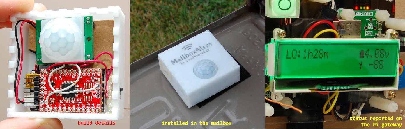

  • Mailbox via MailboxNotifier (aka MailboxAlert or MailMote). This little sensor box can run for many months on a small LiPoly battery and reports back motion detected at the mailbox, battery level, and the last time the mailbox was opened. It became one of the most loved Moteino based devices at our house, and very popular blog project. The love for this device grows more with every Michigan winter storm. Thank you MailboxAlert!

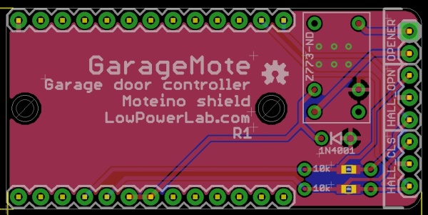

  • Garage door via GarageMote. This device can detect the garage doors position (open, closed, unknown), and trigger an open/close action. Very useful on those stressful days when you wonder if you closed the garage.

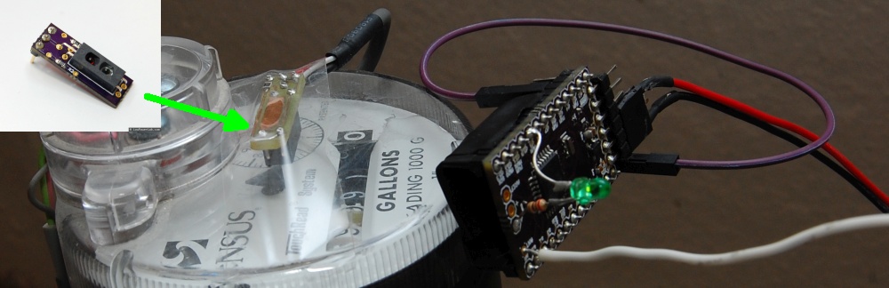

  • Water meter via a photo reflective sensor. Useful to monitor water usage for potential pipe breaks or water leakage.

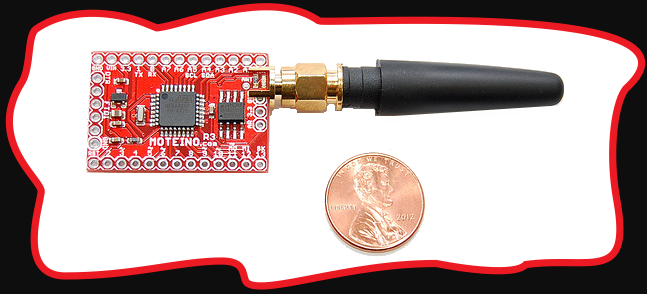

  • 2 × Moteino The heart of the "Moteino Framework". A little SD-card sized breadboard friendly, wireless equipped, atmega328p based development board. Would need at least 2 to make a framework of things. Also a USB version is available and the new MoteinoMEGA for larger more memory intense projects. https://lowpowerlab.com/Moteino
