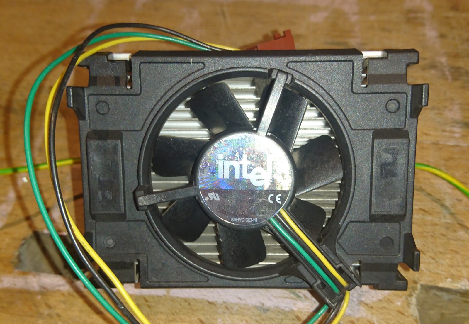

    "build a dummy load to be able to test the current measurement"
    Actually a professional DC electronic load what is able to work above 300V isn't cheap. So I decided to pick a 100W 1K resistor and screwed onto an old s478 heathsink. The question is if the fan have to be used. Finally it worked without it.

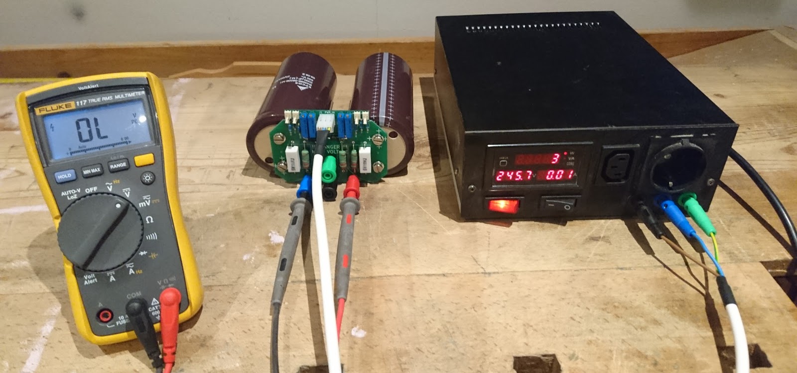

    I've an isolation transformer, as I told before.
    Ouch! My Fluke 117 unable to measure the output voltage.  According to the specification it is able to measure until 600V. In fact it was working until 650V, but the supply is above this. Lets change to a 1000V rated tool:
    So, the PSU works now. My first impression, that the 100k/5W resistors I connected in parallel with the capacitors are improper for draining them. It take quite a long time (several minutes) to do their job, and generating some (not to much) heat during the operation (the 3W consumption on the display of the isolation transformer). It is sufficient  now, but I'm thinking to replace them to some active solution. (an AC Relay with some lower value/higher power resistors maybe).
