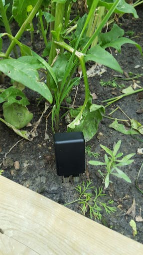

    Programming the mcModule to check soil moisture
    After working out the soil moisture variables (see YouTube video at the bottom) using the wireless debugging feature in mcStudio, we loaded the code onto the module and put into a planter. We programmed the module to check the soil moisture every 30 seconds as well as the temperature every minute and then send that information via MQTT to our broker, CloudMQTT.
    The module is also programmed to check the temperature every minute and also relay that information via MQTT to our broker.
    We also programmed the module to check its battery level every 2 hours and send a notification to a smartphone using IFTTT by setting up an applet to receive the information from the module and then alert on Android (using the IFTTT Android app) if the low-battery message was received.
    *Note - we programmed to check the soil every 30 seconds, the battery voltage every 2 hours and temperature every 60 seconds for the purposes of this example but in real-life and for a long battery life, you could easily set the intervals to only a couple of times per day or mix and match your intervals with the different variables you are measuring to tailor the information to your needs

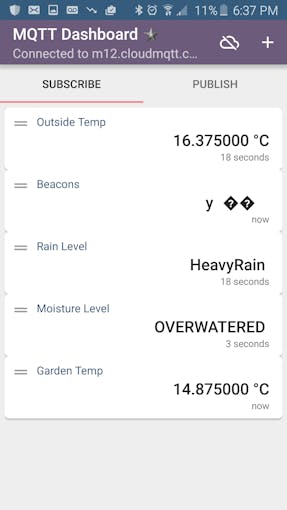

    Viewing the incoming information on Android
    Using an Android MQTT App called IoT MQTT Dashboard we are able to see the incoming information from this device. There are many other great MQTT apps in the Google Play store that you should check out!
    Note - We had other mcModules reporting variables into the app including a rain sensor device!
