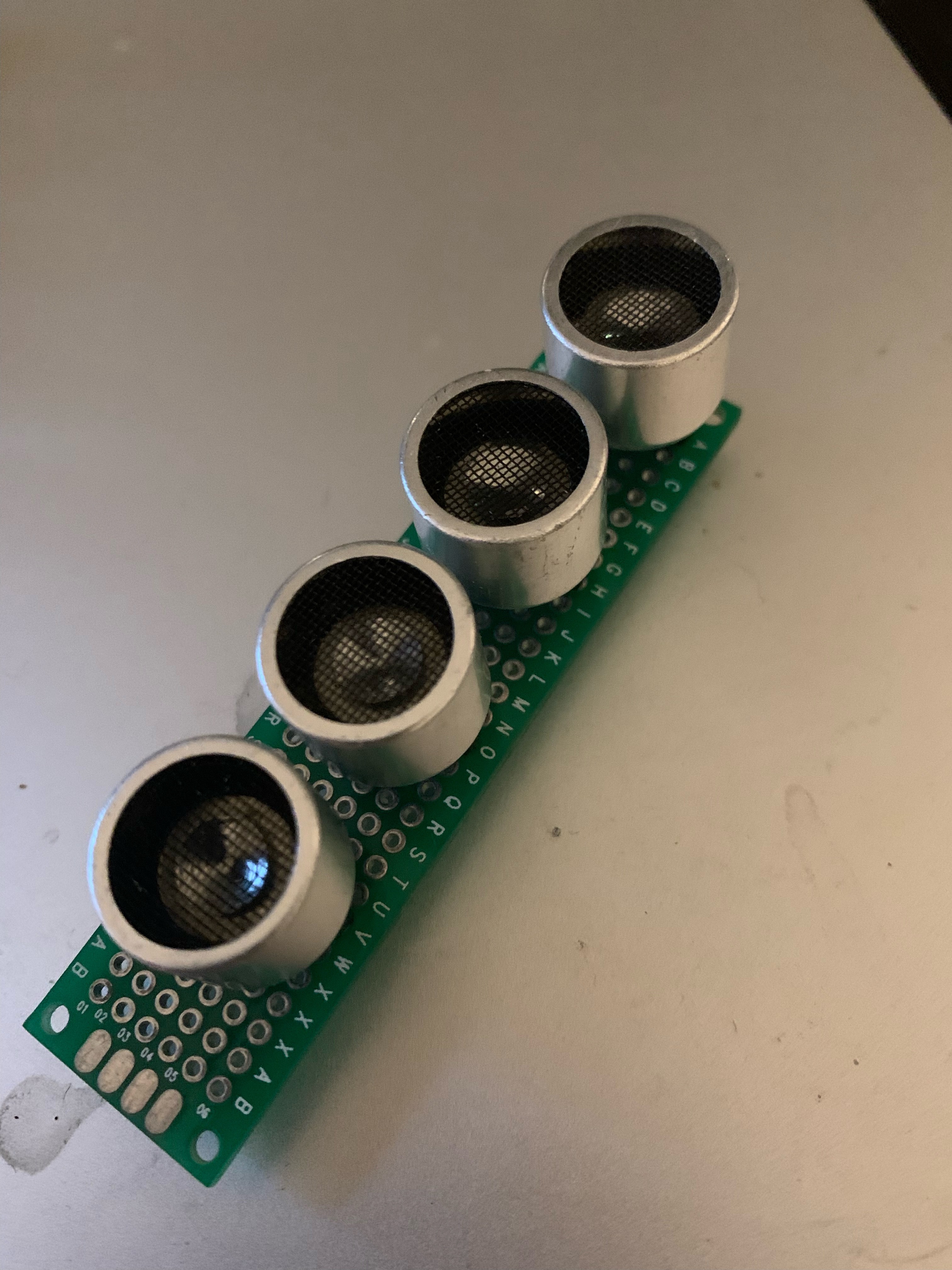

Transmitter 1D 4 channel array
The transmitter array will be used to actively steer the beams in the vertical direction. The transmitter will focus energy in a vertical angles for example, it can be steered to a downwards angle of -30 deg. Receiver elements will only receive echos from the direction where the pulse is steered.
Prototype array for directional transmitter
Beam pattern of the directional transmitter
If signal is transmitted around 12kHz or less, grating lopes should be avoided.
Beam pattern at frequency of 12kHz
Beam is wide, approx +/- 20 deg.
Scanning of the vertical area could be in 20deg. steps, with overlapping.
