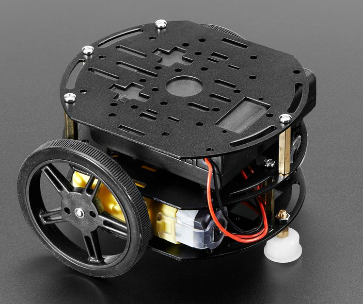

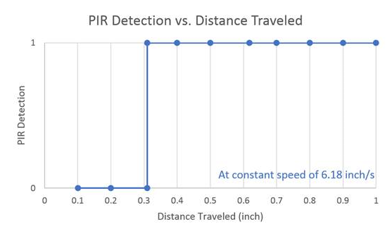

    To more explicitly test this idea, we bought a small robot from Adafruit and programmed it to move back and forth at a constant speed (~6inches/sec), but make movements of different lengths between 0.1 and 1.0 inches.  We mounted an IR LED on top of the robot to make sure it activated the PIR sensor.
    With this test, we confirmed that only movements that displaced the robot >0.3inches triggered the PIR.  Small vigorous movements in place did not.  This test was consistent with our results from video analysis of mice, in which locomotion triggered the sensor, grooming did not.

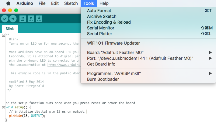

    The Adafruit M0 Adalogger board is not natively supported by the Arduino IDE.  Follow instructions here to install support for this board in the Arduino IDE.  After completing these steps make sure you can flash the example sketch "Blink" to the Adalogger board before continuing.  To do this, open the Blink example in File>Examples>Basic>Blink.

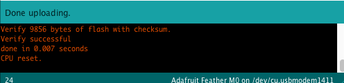

    "Double-click" the small physical button on the Adalogger board to put it in bootloader mode, set Board to "Adafruit Feather M0" and port to the correct COM port and click upload (the right arrow at the top of the Arduino IDE). You should see "Upload complete" in the bottom feedback window and the red LED on the board should blink once per second.
    Congratulations, you have configured your Arduino IDE and uploaded a sketch to the Adalogger!
