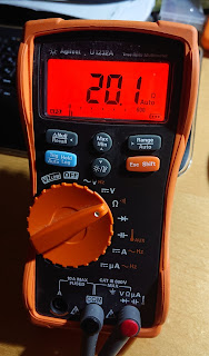

    I'm continuously working on this Curve Tracer in my spare time. I designed a Vishay VO14642 photovoltaic SSR into the circuit. It is quite a nice, but pricey device.
    I thought why not try to order it from Aliexpress. For control I also ordered a few from Mouser.
    Both devices on the same board:
    The original on the left
    The fake measured
    The original measured
    This device should have 0,25 Ohm maximum on resistance.
