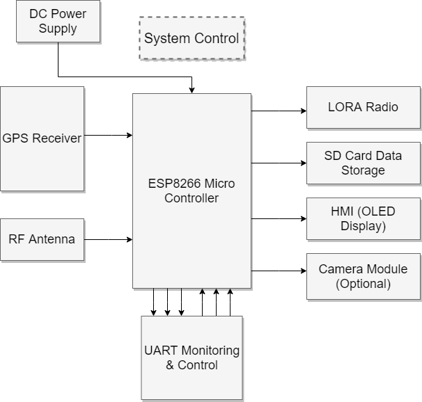

What ResQ does:
  • Detects all Beacons, their RSSI and their MAC addresses
  • Detects All Access Points (APs) in range -not needed but I log them anyhow
  • Gets GPS Lat/Long position
  • Gets GPS UTC Time
  • Logs all the above to the SD card .csv file every time any new target is detected
  • Displays the number of clients detected, APs detected, time and Lat/Long on the OLED screen live.
  • Triggers the camera module to capture an image of the area (optional)
  • Sends the target info to your phone/tablet over Bluetooth (optional)
  • Sends data to remote monitoring station via LORA (under final dev currently)

The air and ground units both use exactly the same hardware/PCB with the only difference being the power supply on the ground (battery) and larger directional antenna on the ground unit. This keeps the instructions, assembly and BOM very simple.  All the parts (except YAGI) are currently even stocked in my local Amazon warehouse here in Canada - Handy!
I am using the Wemos D1 mini PRO ESP8266 (for both air and ground units) with an external antenna (YAGI or omni/dipole) to receive the beacon frames, log them to SD Card with the MAC address and GPS coordinates to  easily plot with Google Earth/maps. It can also transmit the live data telemetry via LORA or similar module to the ground instantly as well by sending the debug UART via  radio to a simple USB  interfaced ground station.
The electronics are simple enough that anyone with basic soldering skills can assemble their own ResQ from scratch or kit in under an hour.
