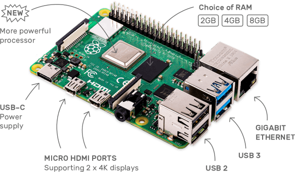

Connect Raspberry Pi
Check out our step-by-step guide:
How to set up your Raspberry Pi 4 for the first time

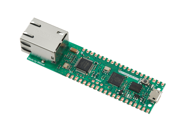

Connect W5100S-EVB-Pico
W5100S-EVB-Pico is a microcontroller evaluation board based on the Raspberry Pi RP2040 and fully hardwired TCP/IP controller W5100S – and basically works the same as Raspberry Pi Pico board but with additional Ethernet via W5100S.

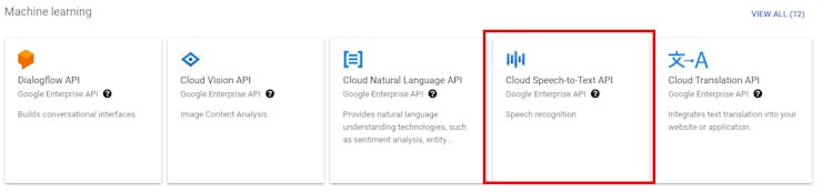

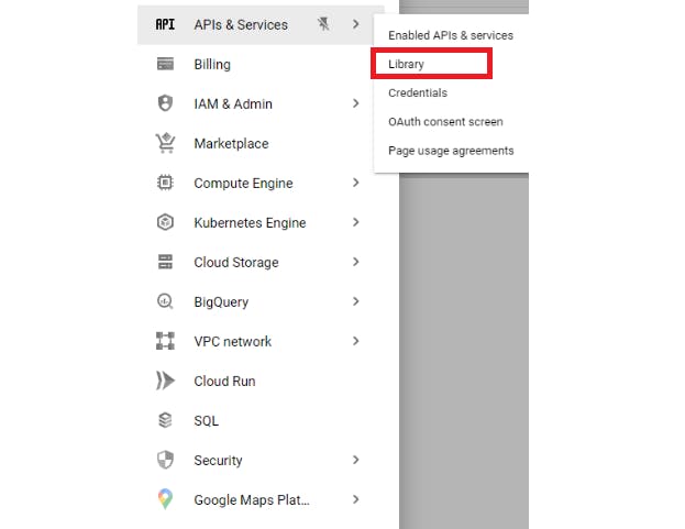

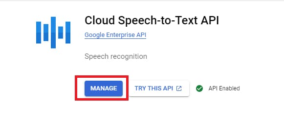

<step-4> Menu -> APIs & servuce -> Library
<step-5> [Cloud Speech-to-Text API] Find and click. [MANAGE] click

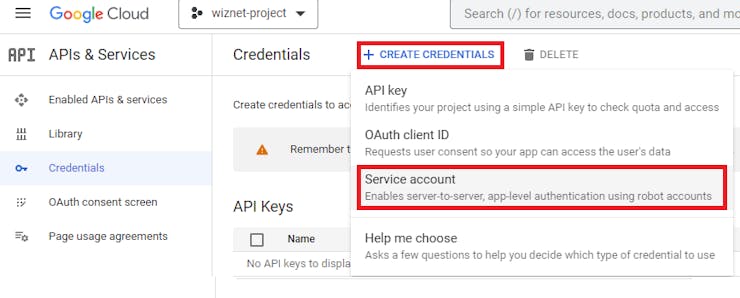

Create User Credentials

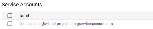

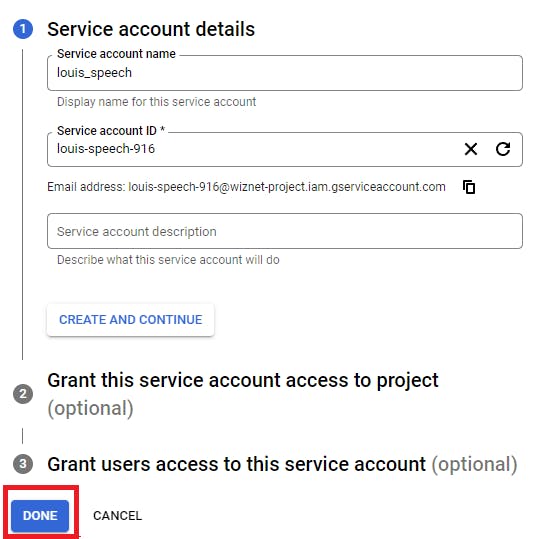

<step-1> [+CREATE CREDENTIALS] select and Service account click
<step-2> Enter a name for the account and press CREATE
<step-3> Verify that the service account has been created as follows:
Create API key

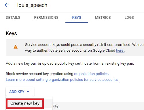

<step-1> Manage service accounts click. Enter the service account you just created.

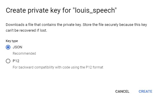

<step-2> KEYS -> ADD KEY -> Create new key
<step-3> Press Create while selected as the JSON format.

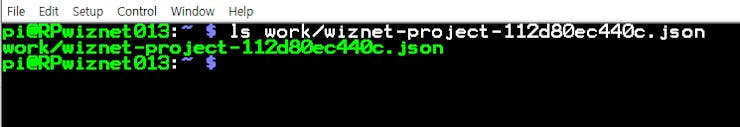

<step-4> Move the created JSON file to the RPi directory.
<step-5> Now it's time to export the JSON file.
example) pi@raspberry:~ $ export GOOGLE_APPLICATION_CREDENTIALS="KEY_STRING"
