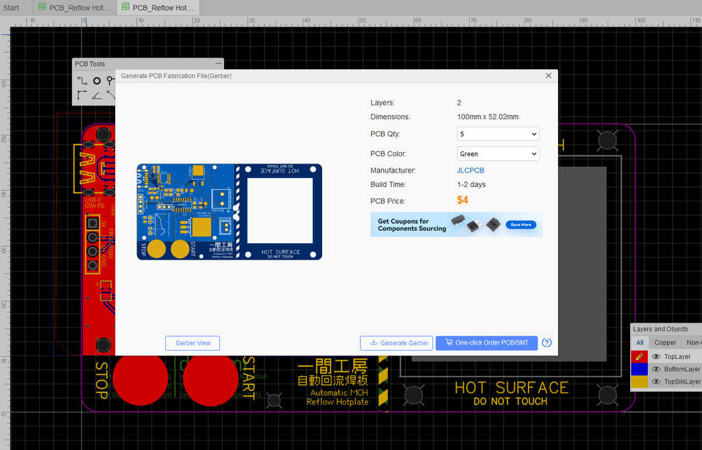

    Send the PCB to Print

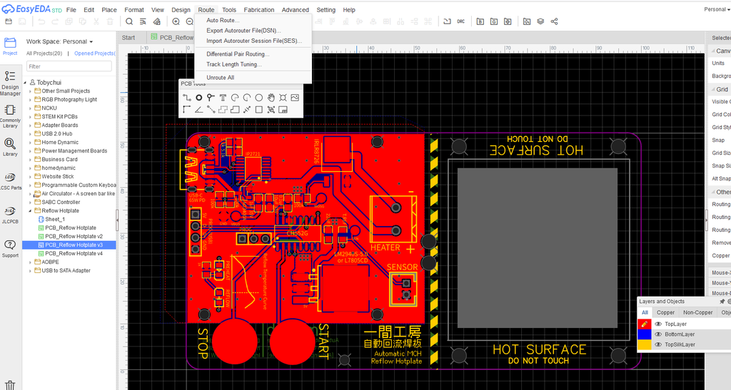

    As the PCB is the main component of this build, you can order your PCB at any PCB manufacturer you preferred. This project is sponsored by JLCPCB. If you have never tried to order a PCB before, please feel free to try out JLC services with the link below.
    https://jlcpcb.com/
    In my case, as the MOQ of the MCH hot-plate is 50 pcs, so I order a bunch of them from JLC so that I could make a few more of them and give them away with only the material costs.
    You can find everything you need for the PCB over here on my github repo.
    https://github.com/tobychui/MCH-PD-Automatic-Reflow-Hotplate/tree/main/pcbSide Note

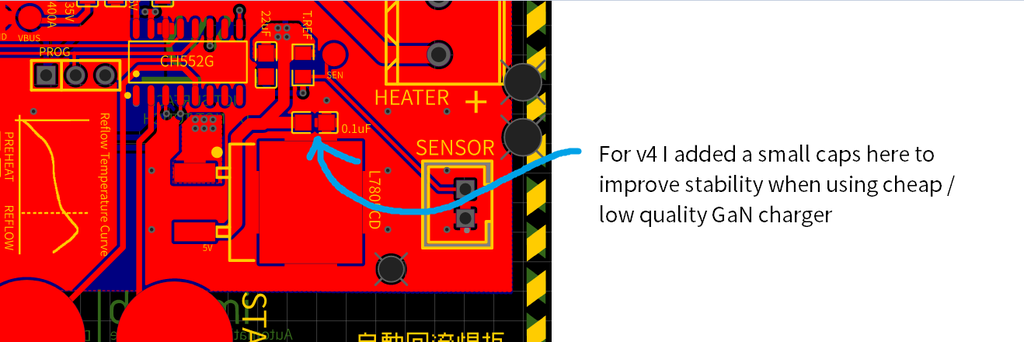

     I am using the v3 design but later I found that adding a small 0.1uF caps over the output of the L7805 improve the overall stability when using cheap / low quality GaN charger with large ripples. This is optional but I recommend adding it if you are making one for yourself.
