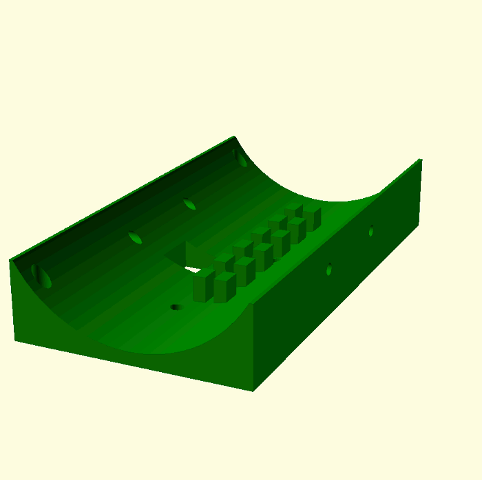

3D printing seemed like the perfect venue for building a laser tag gun (tagger) and I had been modeling in OpenSCAD for a couple years so I figured I was ready to tackle the task of making a tagger. This was the first design, it was going to be propped up on a sturdy tape gun handle and all the parts inside would be held together with machine screws and bolts. I was okay with the boxy design for a first pass. Unfortunately, the parts became larger than my print bed, which was medium at 200mm and much too big for some of the small printers. Keeping the parts accessible to lots of people was important and I didn't want to exclude someone with a small printer.
Here's the first model infinitely exploding and rotating.
Every print was flimsy and refused to fit properly. I even tried to add steel keel down the middle which would add some heft and support but it was a losing battle.
This was only first of many road blocks. Remember that tape gun handle I talked about earlier? Well, this wasn't my first attempt at building taggers and one of my earlier attempts involved bolting PVC pipes together in a gun shape. If you have ever worked with round pipes you will know that they do not play nicely with other shapes. This was exactly the reason I abandoned the idea years ago. Nevertheless, I didn't ignore it as a worthy building material. With the failure of the full-printed tagger, it was time to brainstorm for a building material which was rugged, inexpensive, and accessible.
Plumbing pipes! I bet you saw that coming.
A whole new model was started. This time the printed parts would interface between a piece of pipe and the component I wanted to mount. Have you ever seen a switched mounted on an electrical pipe? No. They are always mounted on an electrical box which has flat faces. How many flat faces are on a round pipe? Zero. This wasn't a match made in heaven but modeling 3D parts around the curvature of a pipe would be a plain matter of some basic measurements and math. Now, OpenSCAD was a perfect match.

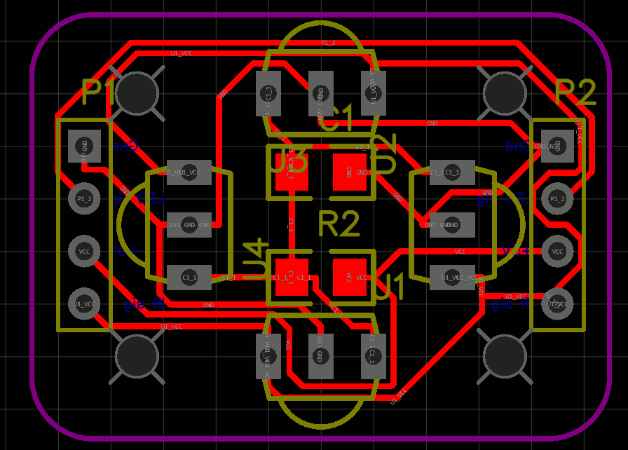

3Sensor boards
Sensor board project page on EasyEDA. When I ordered these boards I ordered 100pcs at a time. They are very versatile in where they can be placed. They were designed to be put inline with individually addressable LED strips. These strips carry 5V power and designate team color so any place where lights can be seen can be made into a target for opponents. These sensors can be used right on the tagger or placed on a hat or vest. The lights aren't necessary, they just need power from the controller board and the signal wire from the sensor board needs to go back to the control board.
Up to four infrared sensors can be installed on each board and only one is necessary.
These boards are single-sided so it's another easy one to make at home but there are 1206 (small surface mount) components but I've already soldered these by hands without trouble or even a magnifying glass. I have good eyes though.The original design had an addressable LED right on the board but that added unnecessary complexity if lights are nearby anyway. These boards can be placed at the beginning or end of and LED strip or even inline since they have pass-through traces. In fact, since most flexible light strips have adhesive on the back so an inline sensor can be mounted without any additional work but they have four screw holes if they need to be secured.
