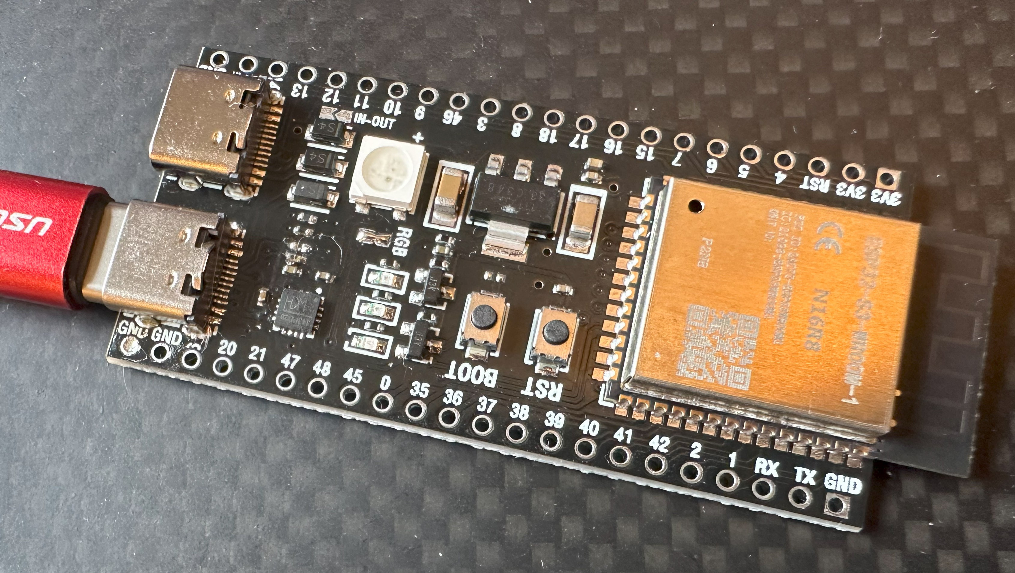

    Can you tell the difference between these two pictures?
    The astute among you will realize that the board works when the USB-C is plugged in one-way and not the other.
    I bought this ESP32-S3 board as part of a batch and it just wasn't working like the others.  Firstly, I discovered that the RGB link needs to be joined for the on-board WS2811 pixel to work.  But more important was finding the cause of the fault.
    My first, and incorrect assumption was to replace the USB-C socket.  Which I did without anything coming to any harm, but it didn't fix the issue.  What I'd failed to catch was the obvious: cable orientation behaviour is based on the CC1/CC2 lines.  ALWAYS check those first.
    Sure enough, my old friend the 5k1 was shorted, but only on CC1.  So I removed it, but because I didn't have any 5k1 "in-stock", I then moved the 5k1 resistor from CC2 to CC1; which is why if you're really observant you'll see a missing resistor on the board.  The CC1 orientation then powered the board without issue, and confirmed that the shorted 5k1 was the only problem.
    So - after a few days I'll have the 0403 5k1 SMD resistor I need to make this board fully working again.  My advice to board debugging?  Never discount the most obvious things before leaping to the wrong conclusions - if I'd done that I'd have saved myself the dicey swapping of the USB-C socket with a hot air gun.
