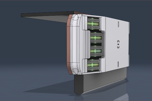

Getting stuff done when you're watching your niece and changing diapers isn't an optimal combination! But I managed to write a little library that handles the display driving etc. So now I have to reprogram everything I had running before, like the enemies that are moving and drawing to the frame that then get's shown.

It looks really nice, but how do you represent the missile from the player and from the enemies ?
I just hope it's fast enough to distract you from the looks :D this project was heavily inspired by this Space Invaders handheld by ENTEX

1mm, but should have been 1.6mm for more diffusion... why do I always change my mind last minute? :D
I’m wondering how did you make the light go throw PCB layer ? And how did you make the different colors of back and front ?
Hi! You can order matte black PCBs at JLCPCB.com. I removed the black soldermask and copper on both sides so the LED can shine through. The LED is also soldered upside down!
