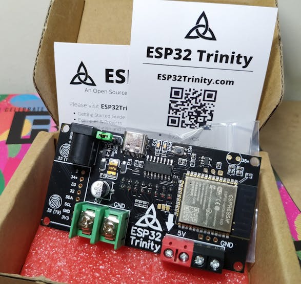

After I made the base code for the clock, I needed a PCB. I really wanted to hang the clock on the wall so I started to prototype my first PCB. I bought a low power laser and adapted it to my 3D printer, so I could design the board that would control the display. This design worked perfectly, although it needs some improvement. You can find it on Github.
Going Pro with the PCB
Tindie has been a great platform where makers from all over the world can create and sell their projects. Brian Lough is one of these guys, I met him on social networks a few years ago and since then he has been working on the ESP32 Trinity a tested and ready-to-use board to control these displays. It couldn't have fit better in this context, all you have to do is plug the board into the display, upload the firmware and voila. Because of this I have retired my PCB that I developed, the Trinity already has everything I need and even more, it even comes with touch sensitive buttons, an LDR (we can regulate the brightness of the display with it), USB-C, power control and much more, you can check more details in the documentation https://github.com/witnessmenow/ESP32-Trinity
