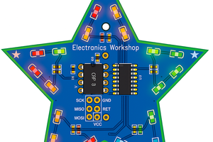

A coin cell sized coin cell powered ring oscillator with LEDs
This is a just-for-fun-project. I wanted to make a small circuit which uses only a few discrete components to make a chasing light like effect.
The PCB is a circle with a radius of 13.5mm. The circuit consists of 7 inverter stages which are connected in a circle. Hence the name "Ring Oscillator".
Each invertar consists of a N-Channel MOSFET, two resistors, one LED and one capacitor.

    Since the PCBs are meant to be wearables, I wanted to come up with a nicer shapes. So I designed a Heart shaped one.
    The idea is basically the same as for the pizza. It's a ring oscillator consisting of an uneven number (in this case 13) of inverters. This one is also powered by a CR2032.
    Two main differences are that for the sake of space on the PCB I use resistor array packages as current limiting resistors for the LEDS and dual packaged MOSFETs. Also there are two holes in to top to add small wire loops.
