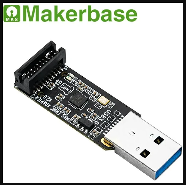

and i order a Emmc adapter from Aliexpress and try install armbian on it again. but its not very simpleafter install armbian latest version elegoos debb file is not compatible with it.

You need to remove Emmc from mainboard its very simple it only has two screws
E mmc adapter i usedI upload files here Odin and image file
