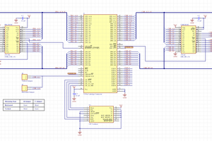

At a high level, the Resistorganizer is a PCB that you can plug into a standard solderless breadboard and it will poll the rows and determine the resistance value of the resistor which is plugged into it (across the DIP gap).
The board is driven by a RPi Pico, utilizing the ADC and some reference resistors to determine each resistor's value based on the voltage divider equation:
Where, in this case, the board is set up that all the resistors stored in the breadboard are R2.

At the heart of this board is a handful of a cool IC, the CD74HC4051 analog multiplexer. This was a revelation to me that (of course) there's a chip out there that can act like a switch and multiplex an ADC. I'm inspired by this chip's bi-directionality. It should be noted that this chip has been replaced by TI with the MUX4051, a drop in replacement with better features.
Since this chip isn't going to be doing hard core signal switching, it's likely an overkill solution. But, if something needs to be killed, you might as well overkill it.
The 4051 has an 8:1 set-up, where you can poll 8 separate signals to the common terminal. Which channel is being polled is controlled with 3 address pins. The chip also has an enable pin, which effectively shuts the chip down. So, after the three address lines and the 'output' line,  each chip only requires a single pin from your microcontroller to read up to 8 signals. Hell, you could throw another generic multiplexer to handle the chip enable pins and get a whole slew of ADC input for a total of... what is that... 3 address pins, 1 ADC, 1 Clock, 1 Latch, 1 serial... so 7 pins for up to a... crap-ton of ADC goodness. I think this is very cool.

Let's revisit the voltage divider equation again and take a look at an issue that arises from ADC precision (or lack thereof):
Vout / Vin = R2 / R1 + R2
In theory, it should be a trivial exercise in algebra to determine R2 if Vout, Vin and R1 are known. Sure. But, in reality, there are things to consider.  The ADC is going to give you a value (in the case of the pico) between 0 and 4095 (12 bits). Where 0 = 0 volts and 4095 = ADCVref (3.3 v). Great, so if the reading is 2053 we can calculate Vout.
Yay. Based on the ratio of the max ADC value and the observed ADC value (~0.5) we can calculate that the resistance of R2 is very nearly equal to R1. Great. But, what if R1 is much, much higher or lower than R2? Well, looking at the equation at the top, as R2 gets much greater than R1, the ratio approaches 1 which would result in the output voltage being equal to the input voltage. The inverse is true as R2 is much smaller than R1, the ratio approaches zero and therefore the output voltage approaches zero.
Resistors commonly used range in values from 220 ohm to 2,000,000 ohm. That's around 2 million values that need to be crammed into 4095 intervals. Precision isn't going to be straightforward here since one ADC interval will cover several resistance values and no one reference resistor for R1 is going to do a good job at R1.
I should have done some research on how a standard ohmmeter does this measurement. But I didn't. I want to roll my own solution. Here's what I came up with and it involves another CD74HC4051. (edit) I did some research and found out that ohmmeters commonly use a current sensor to determine the resistance. I have an ACS712 but a look at the datasheet makes me think that it won't be handling milliamp / microamp scale very well. So... back to the original idea.
The plan to mitigate this precision problem is to select 8 resistors for reference that will range from 220Ω to 2MΩ. These will be multiplexed as R1. So, for each R2 in the breadboard,...

    Forced to the Ground:
    After some debugging, head-scratching and swearing I couldn't find the reason why the enable pin was being held high on the HC595 shift registers when more than two registers were populated on the board. Eventually I gave up and measured the current flowing from the enable to ground, saw that it wasn't too much, and bodged in a 11k pull-down resistor to an adjacent chip's ground and called it good.

    • Revise the schematic and resolve the pull-down issue

    Once installed, the LED don't light up at all now. My guess is that my schematic had some wiring wrong (I've since revised the schematic before I knew of this problem and didn't save the previous version.<face_palm_emoji>, but I can refer to my original files sent to the PCBA house)
    So, I started cutting out shift registers to see if the lights would come back, at least to the first two registers which worked before.
    As you can see in the photo, I've clipped out two so far with no luck. So... keep clipping? Let's hold off for now. Time to get the multimeter out and see if I can tell what's what. Then, we'll get destructive again.
    Yea, yea, yea... I should go find the file with the board schematic and start troubleshooting there. That makes the most sense. But I'll spend 10 minutes finding the file and 45 minutes putzing around the kitchen because, for whatever reason, the mind really doesn't want to engage that way. So, we're working with the mind I've got.

Hey I see that you're going to just the ADC on the RPi Pico and I'd thought I'd share a hard-won tidbit of knowledge I just recently fought with.
The ADCs on a Pico kick like a friggin' mule. It has a particularly low input impedance, so it acts like a ~100K resistor to 3.3V (or ground, I don't remember)  when taking a measurement. Luckily, it's an easy fix to just throw in a simple op amp voltage follower as a buffer.
Or you can use the INA219 Current/voltage monitor that will tell you both the current and the voltage at the same time over I2C. Maybe with a simple ranging setup like I did for this project (or just have 2-3 always connected with different sense resistors, I only needed ranging because the current/voltages involve for this were unknown and possibly huge):

Mike wrote 08/30/2023 at 18:44 point
YES! Thank you!
I knew I should have read the datasheet for the 2040 more carefully (ahem, or at all really). I suspected that there'd be an impedance issue, but second guessed the impact since it's dealing with DC. Buuut, your comment makes me realize that it doesn't matter whether or not it's AC or DC. If it looks like a 100k resistor to ground (or whatever) it's going to impact the reading. I was very close to implementing an op amp buffer (god knows I have enough op amps lying around [for making guitar pedal circuits]) but (wrongfully) assumed that the 2040 ADC input wouldn't be such a current sucker.
